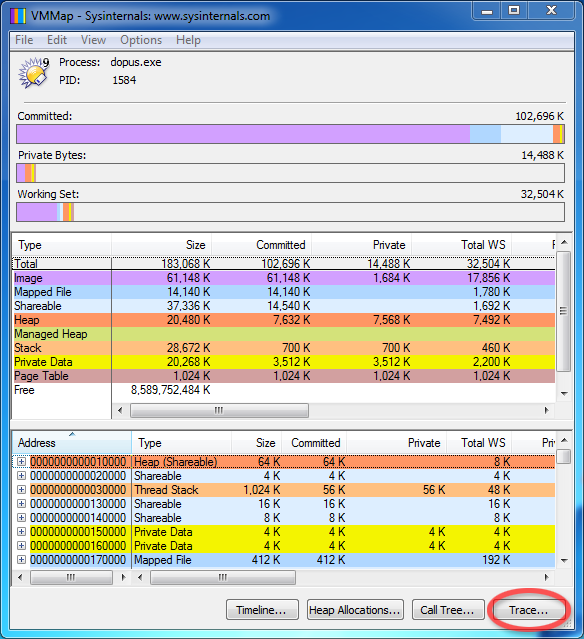

- Return to VMMap and push F5 (or click View -> Refresh) to make it refresh.
- Click Trace... at the bottom of the VMMap window:

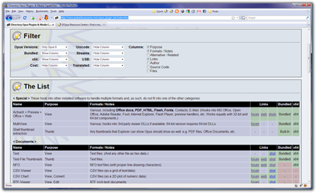

The Interactive list of Opus Plugins & Media Capabilities has been updated so that it is easier to find out if and how Opus can be used to view different types of files.
The list is now split into more categories and now includes several preview handlers and ActiveX controls which work within Opus, in addition to all the native Opus plugins and built-in features.
![](https://lh3.googleusercontent.com/blogger_img_proxy/AEn0k_uoFDn8FX2ZdxwMjC0-bdllNCOomBnPjawv7NYqGiq3yxMsbaB7PPPjbHw8ANOmk-imIu80xs7KWuJaAUetU5sF1uWWKBHUQKp-YRzYdps=s0-d)
(The screenshot above is of the old version, just for illustration.)

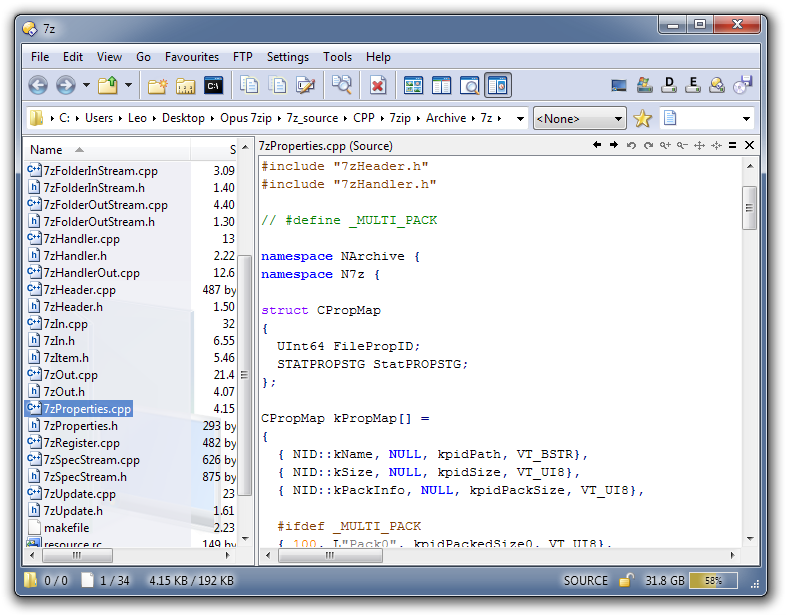

Programmers who wish to view source code with syntax colouring should check out this preview handler:
http://www.smartftp.com/client/addons/sourcepreview
(This discovery is thanks to spiralx at the Opus forums.)
The preview handler was written for SmartFTP and Windows Explorer but it works great in Directory Opus as well. Just install it and you're done.
It works with both 32-bit and 64-bit, unlike the old Source Code Viewer Plugin.
![](https://lh3.googleusercontent.com/blogger_img_proxy/AEn0k_vRoZ0uJakTeOSG0kdET8NA15AdC7Pbj_Ug79Y8vEr_VthWEjzW785g0Qe5dhcIaOEIc3lgjL2OXC_DaV4iyaRCFh9S4B0kvthURWLHSThni0otY8mKJye2YrNpu-mMP6XIZcWL8Z_KWPOwjw=s0-d)
Supported extensions/types:
